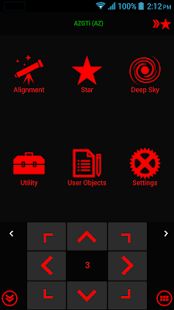

Zkusil bych propojit ručku SWSynScan se SynScan app pro Android
https://play.google.com/store/apps/deta ... synscanapp
