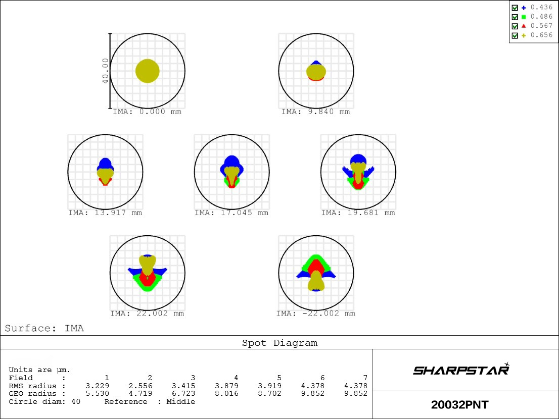

Spot diagram pre Sharpstar 3 "0,85x reduktor, ktorý by mal byť totožný aj pre TS-Optics NEWTON Coma Corrector 0.85x Reducer:
https://www.365astronomy.com/sharpstar- ... corr1.html
