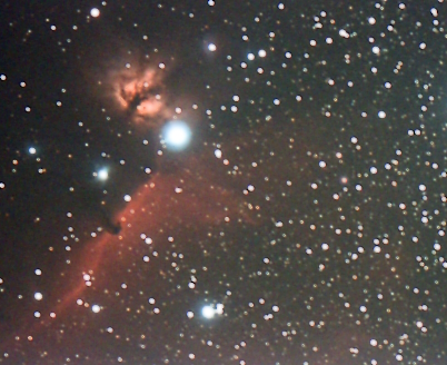

17.3.2023 19:47 SEČ
Samyang 135/2, ASI 482MC, Optolong L-Pro, RAW16, exp. 2.3s, gain 475,
137 expozic LIVE Stack, úprava PaintNet + PhotoDemon
Frýdlant nad Ostravicí

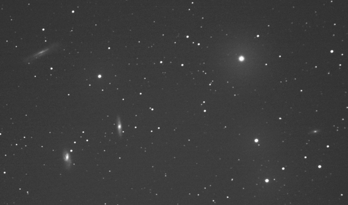

21:28 SEČ
Trojice ve Lvu
Samyang 135/2, ASI 178MM, Optolong L-Pro, MONO8, bin 2x2, exp. 0.93s, gain 510 (max.),
340 expozic LIVE Stack, úprava PaintNet + PhotoDemon

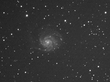

21:43 SEČ
Větrník
416 expozic LIVE Stack, úprava PaintNet + PhotoDemon

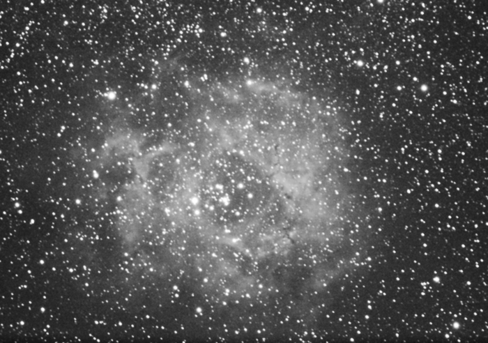

22.4.2023 23:05 SELČ
M81+M82
Samyang 135/2, ASI 178MM, Optolong L-Pro, MONO16, exp. 1.3s, gain 510 (max.),
430 expozic LIVE Stack, úprava PaintNet
