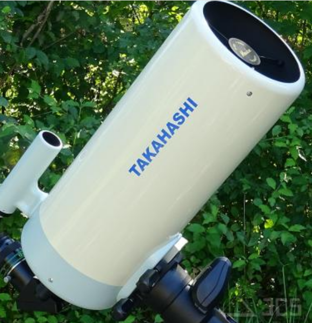

- Takahashi Mewlon 180C.png (846.13 KiB) Zobrazeno 3952 x
