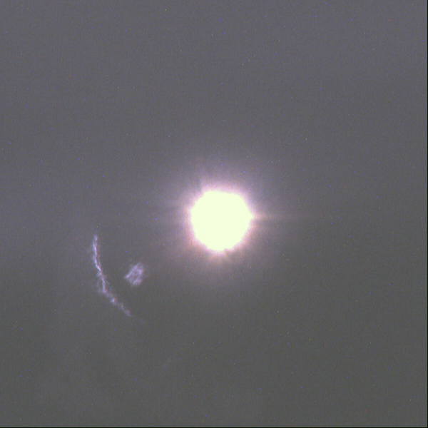

Malý update mé reklamace MN 152.
Dalekohled poslán 15. listopadu na reklamaci do TS. Do dneška dalekohled pořád není doma ( vím, že nejsem jediný ). Ze strany TS nulová aktivita, musel jsem je oslova prosit o nějakou informaci co a jak se řeší. V polovině ledna mi napsali, že čekají na jasnou oblohu pro testování.
Dnes mi přišla odpověď, ze které jsem mírně řečeno rozladěný :
Dear Mr. Pidrman,
this is what the technican told me:
I noticed this:
The extension tube of the pull-out is extremely far into the beam path (see photo "MN-152.jpg").
This creates ugly reflexes and causes a deformed star.
I also took pictures on the optical bench with different exposures.
Here are two examples with 100ms exposure time (2020-01-09-100ms.jpg) and 30s exposure time (2020-01-09-30s.tif)
The two reflexes on the lower right of the 30-second exposed image come from reflexes in the beam splitter of the artificial star and not from the Maksutov Newton.
There is nothing to be seen here of the errors that are on Mr Pidrman's recording.
I strongly suspect that the faults are caused by the extension tube protruding into the beam path.
If you remove the extension sleeve that is currently screwed on, you have to extend the slide further to get into focus.
Then the extension tube no longer protrudes into the beam path. The image quality of the stars is then fine.
There is then nothing to be seen of the brighter colours around the star
Freundliche Grüße | Kind regards
Benjamin Töpfer
First Level Support
Nevím co si o tom mam myslet. Nejsem odborník přes optiku, ale to co simulovali není to co mi to dělalo.
